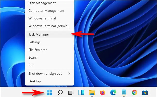

Step 1: Open Task Manager
There are multiple ways to do this:
  • Right-click the Windows Start button (on the taskbar at the bottom of your screen), then click "Task Manager" in the context menu, or
  • Press Ctrl + Shift + Escape simultaneously.
Opening Task Manager from the Start button

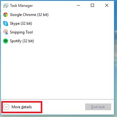

Step 2: Expand the Task Manager Window
Once Task Manager opens you may see a simplified view. To access the full view, click "More details" in the bottom-left corner of the window.
Task Manager More details button

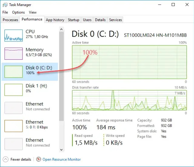

Step 3: Examine Your Components' Performance
In the expanded Task Manager, select the "Performance" tab. Here you'll see your computer's components β€” CPU, memory (RAM), and disk. Check if any of these are at or near 100% utilization β€” that's usually the source of a slow PC.
Task Manager Performance tab
Possible Issues and Solutions
Issue: CPU at 100%
First check the Processes tab (sorted by CPU) to see what is eating the CPU β€” a runaway app or background updater is a free fix. If the CPU is genuinely maxed out by normal use, it may be time for an upgrade. On a desktop, check whether a compatible CPU upgrade exists for your motherboard. On a laptop you might need to consider a newer model, as most laptop CPUs aren't upgradable.
Issue: Memory (RAM) maxed out
If your RAM is at or near 100%, consider upgrading it. To find the maximum RAM your system supports, use a tool like Crucial's upgrade advisor or check your computer's manual using its model number. In the meantime, close browser tabs and startup apps you don't need β€” browsers are usually the biggest RAM consumers.
Issue: Disk at 100%
If your drive sits at 100% utilization, run a S.M.A.R.T. health check with CrystalDiskInfo or HD Tune. If the drive is failing, replace it β€” back up your data immediately. If you're still on a spinning hard drive, installing a solid-state drive (SSD) is the single biggest performance upgrade you can make to an older PC.
